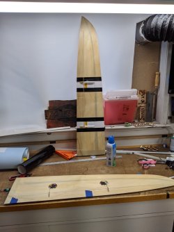

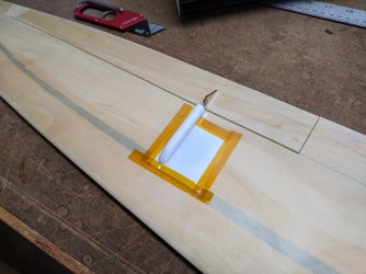

kapton tape to hold em down and than some vinyl for orientation.

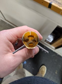

first time doing this but I think I got some epoxy and filler in the places it needs to go. The ones inside I had to basically kind of like drip it down on top of them so it ain't pretty but there's some around it. About 3.5 to 4 grams weight added in the tail.

To get some on the backside (forward) I often use a coffee stick pushed past the mount tubes. Then place the stick against the tubes and draw the stick back, using the tubes as a scrapper depositing the epoxy around the tubes (mount).

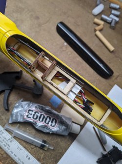

Since this is my first build out of a fiberglass fuselage kit i decided to keep it simple and not put any ballast in at this time. This will be my slower wind plane and let me see what i want/need for the next build i do. Ill be using goop or similar to put the electronics tray in so i could in the future remove it if i really wanted to add a tube later.

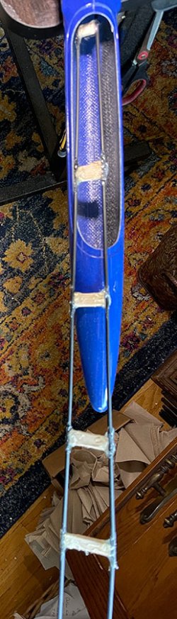

I do have one concern in that it looks like the Bowden tubes have been moved away from the fuselage sides as you come to the servos.
Are the Bowden tubes (outer sheaths) glued to the fuselage shortly after going past the wings? I like how the Bowden tubes look in the ballast tube photo.
In the picture, what your not seeing, is that the tubes are being held to the fuselage by magnets so they dont get in the glue of the ballast tube. The tubes are glued right at the back, to the vtail braces, and in the front they are glued on both sides of that piece of birch ply they go thru. Not glued to the fuselage itself.
As long as there isn't flex between the two anchor point this would work.
Do the snakes feel solid if you hold the servo wheel and try to move the control surface? (You shouldn't see the snakes (Bowden tubes) move as you pull and push on the control surface). Any apparent motion can set the control system into a flutter situation.
I like to run thick epoxy down the outside of the Bowden tube to try to bind the tube to as much of the fuselage for as much of the length as possible.

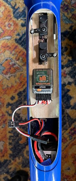

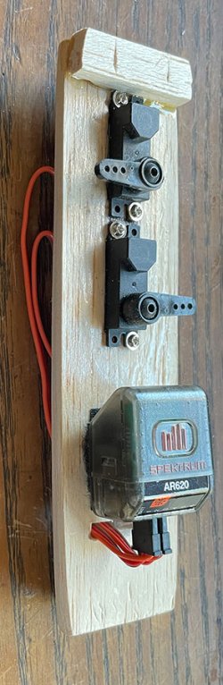

Hi all, just completing my new Sequoia from Aloft, what a nice ship! It's been a challenging build, but I am getting most of it done and thought I'd put up some pictures. This thread has been super helpful to me and thought I'd try and give some back to the group. These first shots are of the fuse section, and the way I put the servos and pushrods in.
