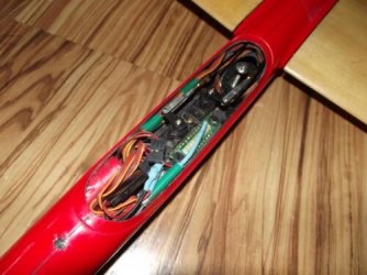

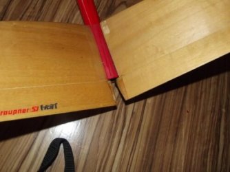

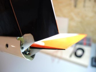

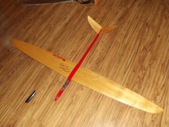

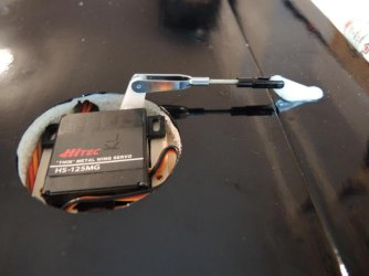

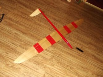

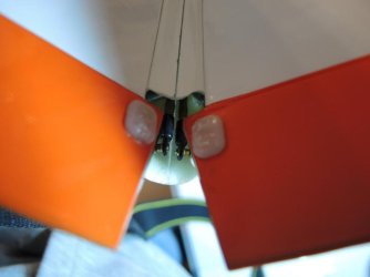

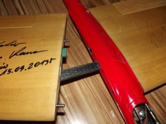

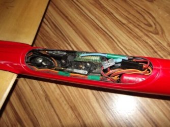

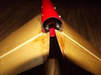

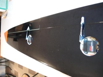

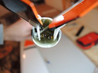

Here are some photos and such for you.
Sounds like the CG is about 75mm. Some may push that back into the low 80s after some flight testing.

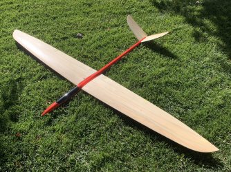

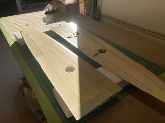

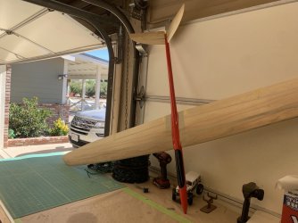

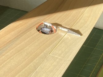

Cool build log! I couldn’t resist and bought one too. I’m a little further behind you though, I only have one wing done. I’ll be watching your build, thanks for sharing.
