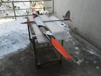

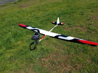

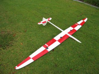

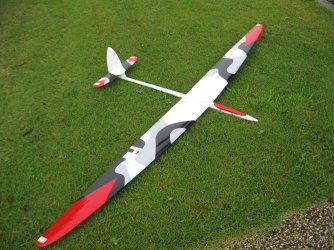

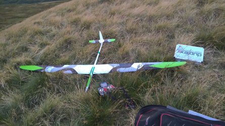

Here are a few pics of the Corsa.
Note the new Ferrari red epoxy paint.
Some coming to Wayne SOON!
