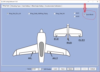

The obvious is to check is whether you tried a substitute servo to ensure no problem with it. swap a working servo. I vaguely remember that the software's blue screen for Aux 5 and Aux 6 has a box that must be either checked or unchecked. (I think unchecked. Manual says select it to turn off the two servos for ailerons.) Being unselected, It let's software know you are using 2 servos but for different functions. i.e. Selecting the box says you are using CH5 for something else like landing gear. One would think the LUA Tx software would do the job also. If you have CH5=Ail2, perhaps that's the same as selecting it. Try undoing that and see what happens. Wish I could help more.
