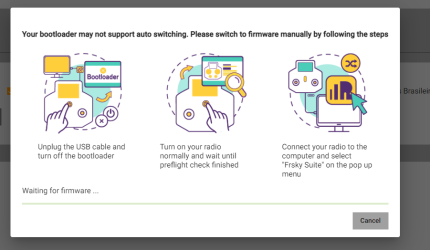

Hi, I believe I have the same X20S issue as above - an X20S which I tried to update via Ethos. My Ethos version also needed updating as it was below 1.5 (1.4 or close to that I believe). I connected the radio using the bootloader USB connection. The radio indicated (and still does) bootloader version 1.4.3. The only thing needing updating according to Ethos at the time was the bootloader, so I clicked on update all components which needed updating. I saw my transmitter begin writing the radio with the associated progress bar. But then it froze with an error message indicating my bootloader may not support auto switching.
I tried to follow the troubleshooting steps displayed, however I was unable to turn off the radio. I had to disconnect the battery to do so. I also found that the radio would not turn on, but I was still able to enter bootloader mode. I decided to update Ethos which I did with no issues. Currently it is running at 1.5.5. However, the radio still fails to update with the same exact error message forcing me to disconnect the battery to turn it off. Also, after the Ethos 1.5.5 update it strangely stopped seeing my radio immediately after connection, but takes about 30 seconds or so for it to be recognized.

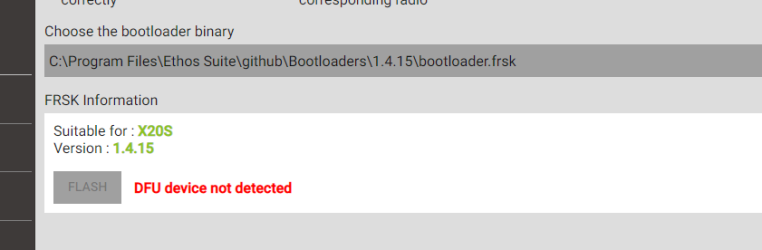

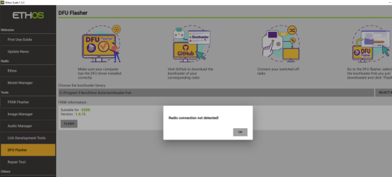

It seems there's clearly a problem with the bootloader on the radio. I looked on Github and found the most recent bootloader listed for the x20s was 1.4.15. I downloaded bootloader.frsk (1.4.15) and attempted to update the radio’s bootloader using the DFU Flasher. I tried connecting the radio while it was turned off but each time the DFU Flasher tool fails with the message “Radio connection not detected!”.
Yes, I've tried this on multiple computers using multiple USB cables. Same result each time.

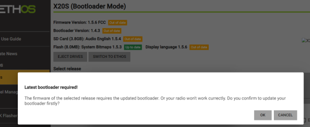

Update: there is a new Ethos version 1.5.6. I downloaded that and tried to update all components but now it cautions me that the bootloader must be the updated bootloader. So ok, thanks ...

The radio will enter bootloader mode. It says FW version 1.4.3.
In bootloader mode I can see the SD card and the flash (NAND) drive. I can start Ethos but it will not update, it fails updating with the "Your bootloader may not support auto switching error." After attempting to update, the radio will not turn off and I must pull the battery.
In bootloader mode, I am able to flash new firmware but the radio still will not turn on.
With the radio turned off (required for the DFU Utility) Ethos DFU Flasher does not see the radio.

I appreciate you guys trying to help. I followed your suggestions as detailed above. And I've tried different SD cards as well. While I can write new firmware by placing the .bin directly onto the root of the SD card, the same issue persists. The radio will not boot and the bootloader can not be flashed using the DFU flasher tool. Is there some other way I can get the bootloader updated? I'm quite sure the radio is ok hardware wise. The SD card I can format all day and transfer files. But the bootloader stays stuck at 1.4.3. Ethos says my bootloader may not support auto switching and the recovery steps (DFU Flasher) do not work.

Well, I finally have this resolved. The issue was that my DFU drivers were broken (probably Windows update). There is a tool to fix the DFU drivers after which the DFU Flasher will work correctly in order to update the bootloader. For anyone interested, Steve from Frsky gave me the following link to download. The tool is:
