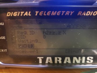

I just soldered the FrSky RX6R but when I try to register the device my TX cant find it, it just waits for 'Waiting'
I even tried to update the firmware on it using the STK as well the sport on my transmitter but it doesn't take any firmware as well, I tried both ACCESS and ACCST. Error is device is not responding while trying to update the firmware.
I have tried both ACCESS and ACCST binding as well, but after setting the FS button and power on, it shows red and green ON that's it.

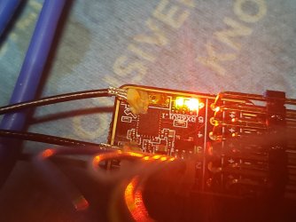

Yes, I just soldered the pins on the RX6R. I do see solid red and green LEDs but I don't see anything on the TX while registering, it just keeps on waiting. I did not program any firmware on it, I TRIED to program but on the STK it was stuck at 'Finding device' while programming from the Taranis SPort it said 'Device not responding'.
I TRIED to program both ACCST and ACCESS FW but it failed. All I maintain an excel sheet with the models and its receiver number so I picked the number which was never used before

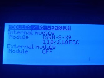

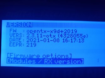

What us V1 and V2? I have posted screen shots of opentx and ISRM versions, what I need to update?
I dont want to mess with my TX since there are 10 receivers connected to it, but I cant even update this receiver with ACCST, thats the another problem
V1 and V2 refer to 1.x.x and 2.x.x versions. The 1.x.x version had the safety issue that Konrad refers to, and it was addressed in 2.1.0 and later versions.
Screen shot #3 shows that the internal module (ISRM) of your Tx is at 2.1.0, so no need to mess with it. A newer version (2.1.6) is available, but doesn't appear to be essential for your use.
Perhaps the Rx was at a rev prior to 2.1.0, which would have caused the binding problem. If you tried to upload the Archer firmware, it is bricked (happened to me). Remove and keep the antenna's, and throw it in the trash. A $30 lesson...
