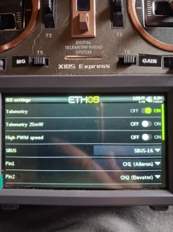

Rx settings menu
John B
I'm not finding the telemetry drop down menu to pick s port, f bus etc in my archer plus sr10+. Trying to get my battery sensors to work, I've tried the 4 pin, tried assigning s port to pin 10.
Discover sensors bring up lipo, but no values, just 3 red dashes.

In the model settings, navigate to the telemetry screen, it may be on the second page. Then click on the find sensors button while the receiver is bound and powered. You should see your sensors pop right up.

Lipo shows up, no data, just a 3 red dash line. I've tried another sensor, one I received today new. 3 different firmware versions on the archer plus sr10+, even another new sr10+. Re did ethos 1.5.19 on my horus, nothings worked.
Only thing I can think of is a conflict with one or more of the recievers telemtry it sends back.
Tomorrow, I'm going to delete one sensor at a time and see if that gets the floss to work.

I am going to delete the radio bin tomorrow and try it. Had to do that before because ota flash wouldn't show up when I went to flash firmware on receiver, deleting the radio.bin fixed that, I'm hoping doing it again will fix it.
Something with ethos suite while upgrading firmware messed up my radio, did it before when I tried ota flash, after i had fllashed firmware from it, now sensor not working.

Never had a problem with ota flashing. I had gone to ethos suite to flash radio and download some receiver updates. When I went to update, in the menu, there was no flash option for anything. So I deleted the bin file and it fixed it. Had to re do global variables and radio settings, but it worked.
I went back to ethos suite to back up my radio and install lua scripts for my new recieivers.
Then when I went to install my floss, it would recognize the sensor, but no data. Tried 2 sensors I gad and a new one I just got, nothing, didn't work.
Later, I'm going to delete the bin file and see if it solves the problem, I have a strong feeling it will.
Anyway, I think ethos suite corrupted my radio both times.
