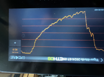

OK the mystery continues. Another crash. This is a different plane, neuron esc (a different one), Archer SR9 ACCESS receiver. Range check OK. Plane took off. I began a right hand turn and progressively lost control. At the time the plane was about 200 feet away. As everything stayed hooked up, telemetry continued. You can see a rapid drop in RSSI until impact. Then as I walked towards the plane you can see the RSSI increasing again. I have no idea what is going on. The only other possible factor is I have a Marco Polo plane finder attached. (and have used it on all planes for the last couple of years but not with the new receivers). It operates in the 900mhz band I believe. I am only using 2.4G and have the X20S 900 transmitter turned off. I have attached the RSSI log.

I'll second the VFR (Valid Frame Rate), it is a better indicator than RSSI. (VFR uses RSSI and the quality of the packets received.) A strong RSSI and a weak VFR is a bad sign and totally possible. This would indicate interference at the field.
Hope this helps.
Also strongly suggest ground range checks before any more flights.
