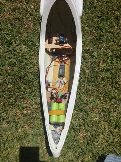

Also set my rudder servo in the front (kind of between the wing joiner tube and the canopy) with pull-pull. and even with that if I remember correctly I needed to add over 500gr of lead on the nose. Fly weight if I remember correctly is 5550gr.

So I attached a pic of the front setup on mine.
Fernando
