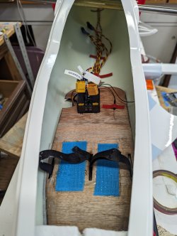

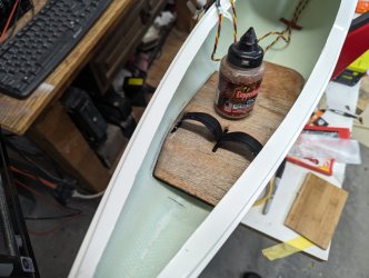

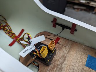

Looks like I need about 1.2 kg in the nose to hit CG. So now that I know how much space I need for that, I made up a quick battery and electronics tray this morning. Still need to add some velcro for the batteries once the epoxy dries

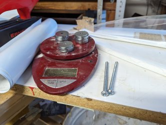

current thoughts, are to put less than i need into the front cavity as epoxy/lead as discussed before but sink some bolts into it sticking up that i can use as an anchor to tighten more weight down that is adjustable. Ill think about it.
Mount a frame in the nose that you have have studs sticking out of and shape steel plates to stack on them. Then you can add and remove weight as you please.

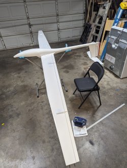

I got one too! I finally managed to maiden it last Saturday
