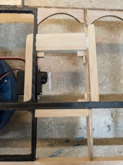

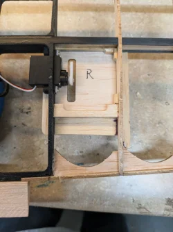

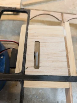

Here's how I made the servo covers removable. Just a bit of scrap balsa to support the covers, and then some strips of balsa around the frame to give the covering something to hold on to.

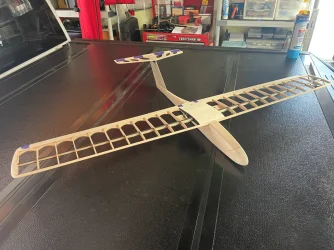

Another one built and sanded, ready for covering! These build quick! Probably more time sanding than building, lol. Not counting beer time…..😎

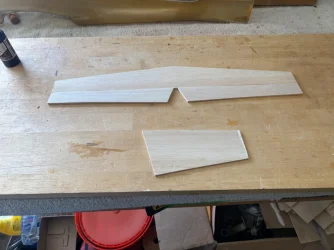

Man I miss the old days lol. Great Planes used to sell Balsa building boards for about $40 that were laminated about 3/4" thick. Mine is about 16" x 48", you can see it here. I get it resurfaced every so often at the local wood shop, they run it through their surface sander and take about 1/64" off to the the glue blobs I eventually get on it. I took it for granted for many years, with balsa prices now I am much more careful! It's like it is gold plated now haha.
EDIT: Found an old listing for one. Man this hobby has changed so much over the years. https://www.greathobbies.com/produc...tI68-Zk-zX4ctA-8Z895CjVNz3Ly5fKdccYcLs1pjkTMm
