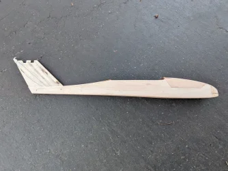

Fuselage is done except for final sanding. I made a couple small errors, but they seem to have worked themselves out in the end. The only place I really diverged from the instructions was to use wood glue to attach the top and bottom deck, and also to laminate the nose pieces. I like to use wood glue any place where I know I'm going to have to sand, and where I want a little bit of extra working time.

That is a very good point!! Wood glue is far better choice if you are not in a hurry.

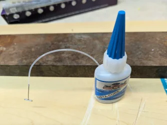

Speaking of glue tips (literally and figuratively), here's one for thin CA that I learned from a friend, who in turn got it from Tony, of Tony and Addie's Hobby Lobby, the late, great hobby shop in Burbank, CA.
Get a piece of thin teflon tubing. Using a t-pin or tack, poke a hole near the neck of the CA bottle (there's no need to ever open up the actual glue tip of the bottle). Then, simply feed the tubing down into the hole and into the bottom of the bottle. And that's it! you'll now be able to deliver thin CA incredibly precisely. And because it's a teflon tube, it never almost never clogs. Even if it does clog, it will only be at the very end, and you can just snip that off.
One warning is to always stop the end of it when your building session is done (as you can see I've done here with a t-pin). Otherwise, in certain conditions, I guess caplillary action or something can take hold, and the CA will just start leaking out by itself (ask me how I know).

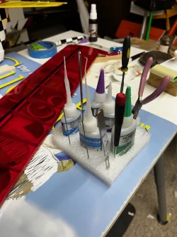

As far as a building board, I just repurposed a foamboard sign and a random piece of foam for a tool caddy.
