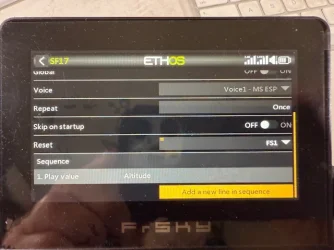

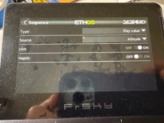

Play Audio is what you want. After adding that go to the bottom of the screen and you will see this:
Add a new line to the sequence and you get here:
The reason for all this is that now you can play multiple sounds and can play values as well as files. It's much more powerful now.

Yes things have change a bit. So select play audio then proceed to the bottom of the menu and select "add a new line in sequence" then you will find play value.

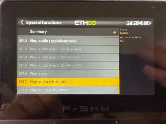

I'm having problems in this same area. I am following the steps above-I also was going crazy trying to find "play value". New X20RS with Ethos 1.6.3, Neuron II ESC, and TW GR8 receiver with vario- all upgraded firmware. I am trying to use Special Function 17 using switch SC (middle) to get altitude callout. I have configured SC up for "play vario" successfully. I have configured volume control on Tx at pot 2. Both vario and altitude use the receiver vario telemetry- and both show up active in telemetry screens. However, I am not getting any callouts for altitude. I'm also trying to set up GPS speed callout for SC (down): again, no callouts. In Special Functions, I am seeing SF16, SF17, and SF18 go dim/bright as I move switch SC. My callouts for "speed", "thermal", "landing", etc. are working. Do I need to specify a voice source somewhere?
Any help much appreciated......

SOLVED
In SYSTEM>GENERAL>AUDIO>LANGUAGE, VOICE 2 and VOICE 3 were blank. I populated them with US and GB audio files. THEN in the MODEL>SPECIAL FUNCTIONS>EDIT screen, selected VOICE2, us. Now I get callouts for the different flight modes from the VOICE 1, (Mike Shellim tracks folder)- and altitude callouts from the VOICE 2 us audio folder.
