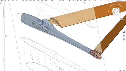

Please do following improvement on the tail within the next generation of Redshift fuses (like Pic) :
The carb rods should go through the structure and can be way thicker. Just my advice. The fuselage thickness on this section is OK and the stabs can be better fixed with two crossings through fuse with proper material.
Hum? The original Redshift manual supports the idea of carrying the stab joiners through the opposite fuselage wall.
Don't know how the carbon rods could be made thicker (larger diameter) and not violate the stab profile (airfoil).
The only problem I saw with the V tail was that the control horns were too short. Also "I'd" like to see a V-tail angle closer to 104°-100°. All issues being addressed.
I only know about the epoxy filets that can glued inside the fuse to stab the stab joiners through. The opposite fuselage wall solution needs longer rods. The foil can handle a larger diameter.
v-tail angle is correct, you really can twist and pressure it in the corner/turn. ButU must be sensitive
, other wise it wigglezz ↔️
Is the change of this carbon rod to one with a larger diameter also a mould problem (to change the aluminium plate?)??
Really, you are concerned with the 2mm needed to push through the fuselage wall? As to a larger diameter I see it as a geometry issue, the stabs just aren't thick enough to be able to use a larger diameter rod. I though this was your concern "The carb rods should go through the structure and can be way thicker". The 5mm solid carbon rods are more than strong enough, maybe too strong!
