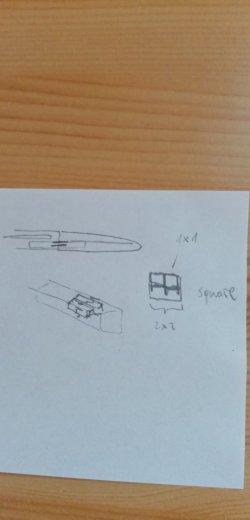

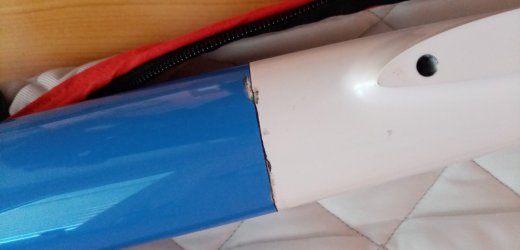

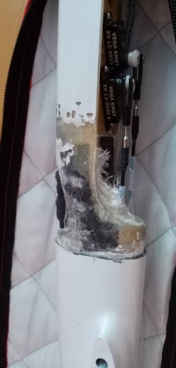

slightly off-top I cured the damn landing approach from 14.June
We will see if it holds, fuse ballast tube is now out of order
@Konrad flying stuff from slot, wrecker or the coast??
