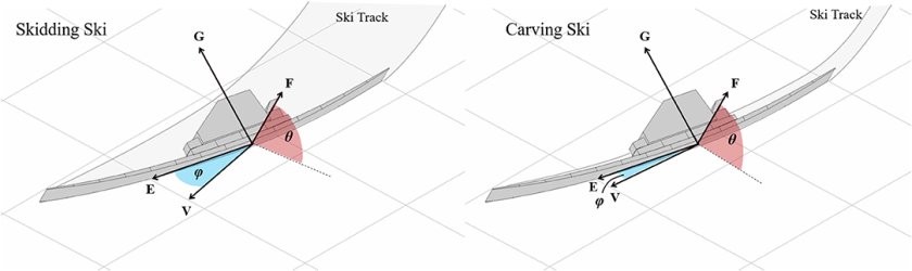

Since I spent more of my life on snow skis then flying gliders, here is what my snow ski analogy is for a carving skis. I have some old Atomic Slalom race skis that, when loaded would 'ping' me out of a turn and into the next... Some skis stored more energy then others. Some had fancy top layers of materials to limit the amount of vibration after the 'pinggggg'
Hey GP:
The Mongols used this "fancy top layer" theory (I like that!) on thier short but very powerful bows. The bows had to be short as they were used from a galloping horse. (or so my dad told me)
Different types of woods with different bending tensions along with sinew bonded with resins in strategic positions on the structure gave a REALLY good ping.
Probably one of the first composite structures that really did its job...which was to...PING.
Just imagine what would have happened if they had continued to use those super rigid 3" oak beams as bows...death would probably have been part of the equation.
It's all been done before; Its all there for the taking...
Lets PING!
