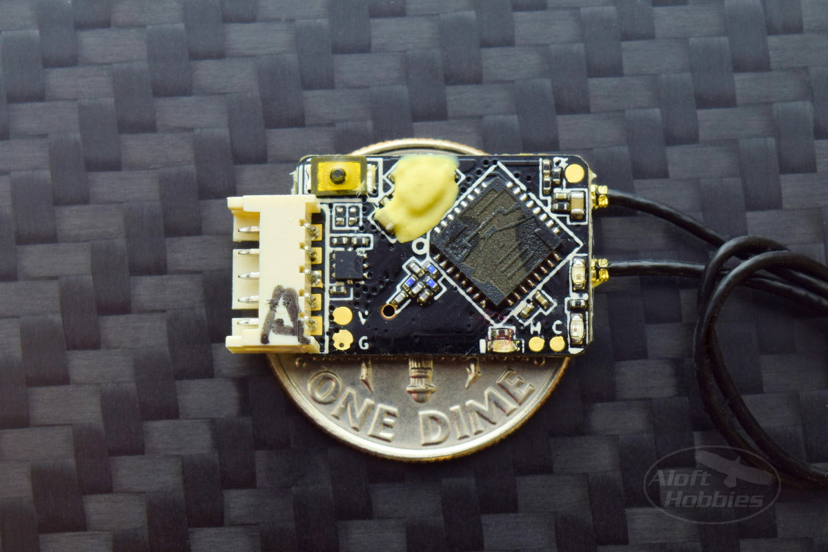

For the 2.4ghz side, just pick the receiver you would like to use, bind it, and connect the "Sbus Out" of that receiver and connect to the "Sbus In" on the RB-20. On the RB-20 they call this "RX1 In" and RX2 In". For receivers, doesn't need to be anything big, this will do the trick:
This tiny little receiver weighs just 1.5 grams, yet still packs all of the great features of its predecessor, the XSR. SBUS, CPPM, full range, full telemetry, Smart Port to add sensors. This alone would have made it very popular, but FrSky added 2 new it
alofthobbies.com
It is full range and saves space in the plane. The receiver will get its power from the RB-20. You will have 3 wires running to it, red, black and the Sbus line.
