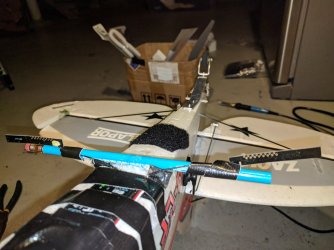

For signal loss redundancy I'm using the RX8R w/ telemetry as my primary/master receiver which is wired up to an X8R w/o telemetry, the slave receiver, primarily to avoid line-of-sight shielding of the relatively big lipo and the esc as I've had a few brief failures and low RSSI dips. It seemed apparent that the RSSI and the distance of the plane had no correlation (strong RSSI at 2K feet, weak when coming in to land much closer), rather I'd get dips when the plane was aimed at me at a particular angle. So I bought the RX8R, put it under the tail of the airplane, and wired it to the X8R up at the front as the slave receiver. So far no failures with the RX8R + X8R that triggered failsafes, but I'm still paranoid about flyaways and just ordered the R9R. (Also using the Castle 2.0 BEC.)

Antenna placement, what's the way to go, to position them such that both of the two antennas are never perpendicular to the transmitter, not the other way around, and the farther spread away from each other the better? How about curving the antennas a bit, or should they be kept straight? Should I avoid using certain types of tape, like duct/Gorilla tape, on the antennas? If the antennas get wet when taxiing, no big deal?
