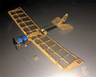

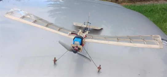

While we are at it on gear, my smallest plane comes in at 80 grams, 21" wingspan, it's called the Mini Jenny stick. I'm sharing the rabbit trail of electronics I used and/or recommend for it. It took a great deal of effort finding just the right combo for this class of plane, it's also something I would rather send my customers over to you for the gear so it's a one stop shop rather the spread out all over the place.
