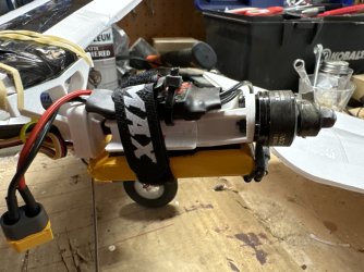

I believe I have it correct with the flat surface down.

I believe I have the motor mount correct. Flat spot is down.

Yes, this looks correct. As viewed from the side the motor should be pointing downward about 3 degrees. If needed you can increase the angle with some small washers or other spacers between the motor and the motor mount, but really should not be needed.
This is a trainer, so we have some angle of attack on the wing, and this will cause it to change some with power input. This is by design, but should not be a radical amount. This angle makes the plane slower and easier to fly for a new pilot.
