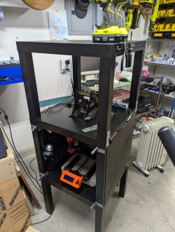

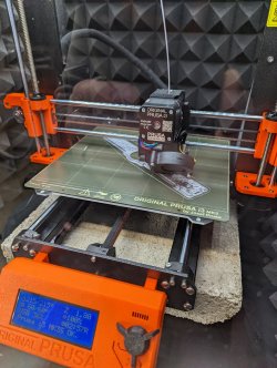

Prusa i3 MK3S+ Build log and the road to "the quieting"

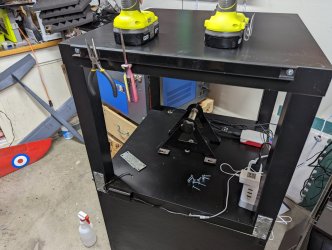

Third layer connected with just some straight metal connectors and a harbor freight magnetic tool holder on the side.

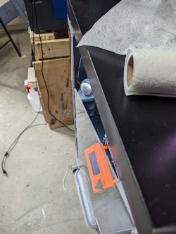

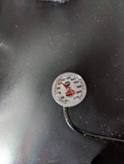

So after doing a couple 3-hour prints I found that if I crack the doors open a little bit as shown in the picture that it will keep it right around 90° f inside. Which is I think you want between 80 to 95 for PLA.
