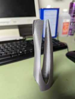

I'm really beginning to think that, even for structural pieces for larger aircraft, if carbon fiber reinforced nylon might be a better material. From what I've seen, its lighter, and stronger than some of the more common filiment?
It also seems to flow better from vids I've seen online. JohnnyQ90 made a nitro exhaust from it and it stood up to high temp really good as well.
Wheels made with it (for rc) were almost a half a gram lighter than the same printed from resin.

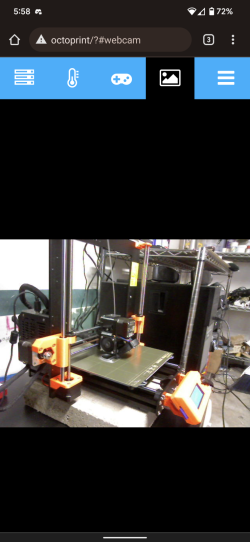

Can't recommend enough octoprint with the octoeverywhere plugin. I was able to upload a file from off-site and start this print and than monitor it remotely. At home I even use it on my phone to take a peek at the printer to see how it's doing. Even stopping a few failed prints before they wasted too much plastic.

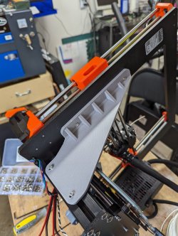

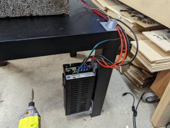

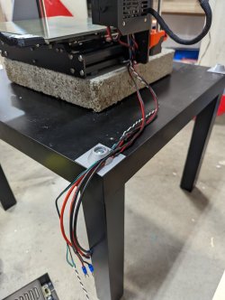

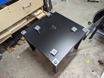

Slowly getting the stack configured. The bracket below braces the frame where the PSU used to be as it gets moved outside the box.

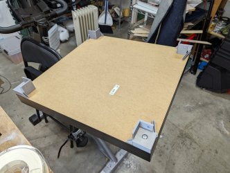

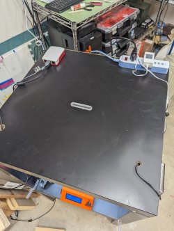

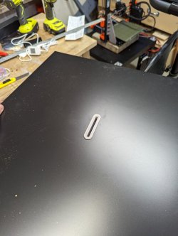

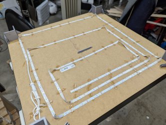

This table is the layer that will be directly above the printer so as a 3D printed filament pass through.
And then underneath I put some sticky LED lights but as I've had this tape repeatedly fail in the past. I spread some e6000 across the LEDs all over and I can confirm this morning that it made a super solid bond.

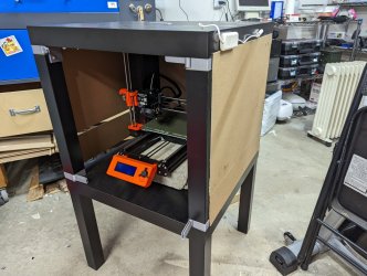

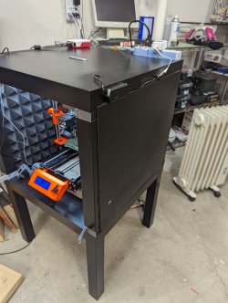

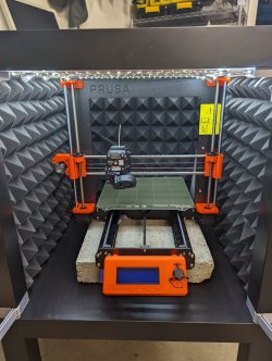

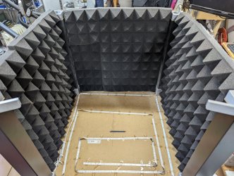

@gp49 The printer is surprisingly quiet but there are some quick moves that will make noise so hoping that this 3 sided soundproofing will drop the sounds alot. It will have the plexi in the front as doors though.
I have some thermometers i am going to place inside to monitor the temp and will decide later if i need the fan.
