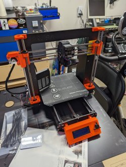

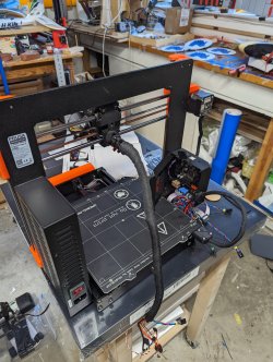

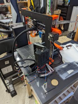

Almost done.
PXL_20220320_013131301.MP.jpgPXL_20220320_013136155.MP.jpgPXL_20220320_013142145.MP.jpg
Does it come with an SD card or the little silver usb drive? If you have the USB drive the best thing you can do is throw it away.

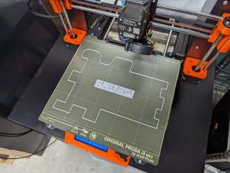

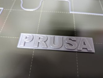

@Nigel it came with the sd card. Printed out the prusa head beer opener this morning with it.
Congratulations Nate!
I can tell by your test print that you have your calibration dialed pretty close. When I was setting up my, I was very shy about dialing the z axis down and printed about 8 of the test prints before getting the curves in the test print to stick properly to the build plate. My grandkids each have several Prusa Logos to play with.

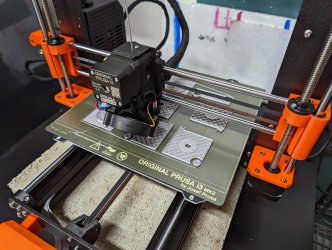

walked out to my shop this morning and just hit the on button and selected the beer opener test print. Pretty awesome that i didnt have to do any bed leveling and it came out pretty much perfect.

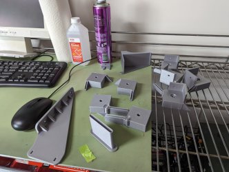

I started off the lack stack project by printing the Power supply holder. 3.5 hr print on pla. This moves the psu outside the enclosed box so it doesnt get hot.
*** @Wayne we can upload video files directly now ??

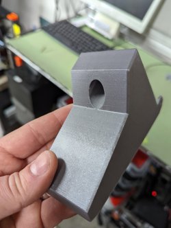

That came out super nice so today i am trying out a 9.5 hr print. This is the bottom corner parts of the lack stack

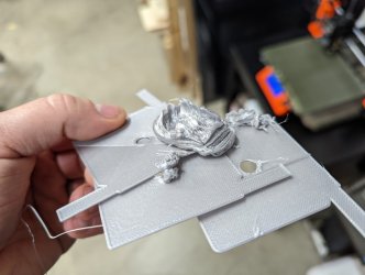

Had a couple false starts this weekend but after some assistance from @RafaelAvila and another friend i got the last of my ikea stuff printed out. I ended up cleaning the bed with isopropyl, spraying some aquanet, and increasing the bed heat by 5c as this is in my shop.
