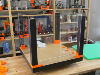

The standard lack stack usually involves plexiglass on all 4 sides as seen in this picture, with the front having moving doors to access the inside:
I am going to modify that by changing the 3 non door sides to wood and putting some sound dampening egg crate style foam on the insides and possible on the top as well.
And than the usual led strip lights inside.
Ill have to monitor the internal temps, if it gets too hot ill add some vents.

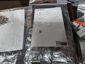

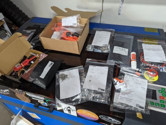

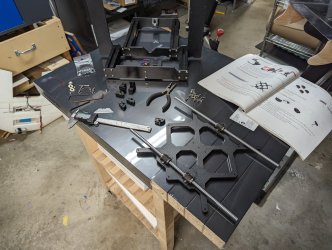

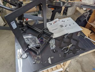

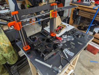

Everything sorted really nicely into baggies that follow the instruction booklet. While it was kind of intimidating seeing so many parts, the instructions and the way it sorted makes each page you go through the instruction book really easy and manageable and not overwhelming, so pretty impressed with that so far.
PXL_20220313_162633452.MP.jpgPXL_20220313_162639852.MP.jpgPXL_20220313_162643819.MP.jpgPXL_20220314_150520652.MP.jpgPXL_20220314_150523881.MP.jpg

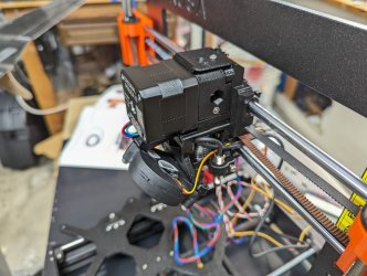

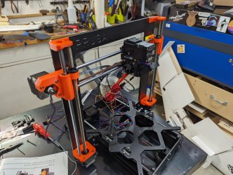

Starting to look like something. Currently working on the Extruder/hotend which i have been told is a PITA. The instructions even say its the hardest part.

Extruder almost done, A very enjoyable puzzle. It's amazing how the parts fit together. Having said that, if I ever have to take it apart, I'm going to find a way to drive across the Atlantic Ocean and punch Joseph prusa in the face.
