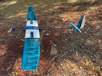

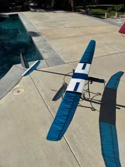

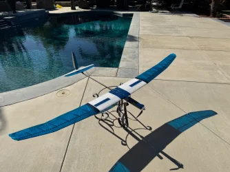

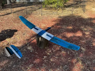

Almost there. Kit arrived from Aloft on August 13th. Just need to touch up the covering. Adjust the interior electronics and do a W/B. Fingers crossed it comes out close. This glider has a hatch on top and bottom. Servos are mounted upside down to give more room for battery, esc and receiver. Front of fusalage is widened a few millimeters so I could fit in a Dualsky 2325 canned outrunner with the wires coming out the back 👍. Probably maiden next week. Then I plan to make new hatches. Their design is way too flimsy. Next build AH-100 😃

Looks great! If she flies half as nice as you built here, she will be fantastic!

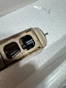

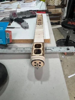

This is the Dualsky I used in mine. Works great but I widened the nose when I built in anticipation of this motor. If your fuselage is complete it might not fit. Perhaps ask Wayne about the new spinners with the motor inside. That might be ideal.

And here are a couple of pics of the motor during the build.
