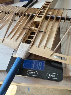

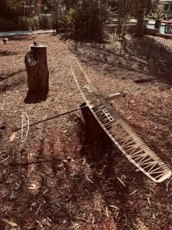

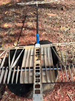

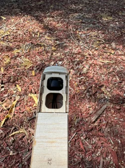

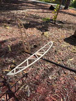

This is a CLM Pro prime RES 3 I am working on. Like all kits its an interesting journey from the excitement when the kit shows up to the anticipation of the maiden flight. Some frustrations along the way but we always learn from them. One thing that went well, I was able to widen the nose just enough to fit a Bluesky cased outrunner. I just don’t like the spinning cases with the wires coming out the side and bent over. Seems like a problem in waiting in tight glider noses. Current weight with just the motor is 375 grams. Probably will end up around 500. One step at a time and the first flight will happen.
