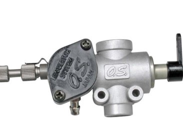

The pump feeds the pressure regulator and the regulator is an integral part of the carb. If I were to bypass the pump, I'd still have to use the pressure regulator and in that case the engine may not run. I have attached a pic of the carb. The black thingy in the pic is the pressure regulator. There is a diaphragm inside which is supported by two springs. The diaphragm looks OK as well as the springs but I have no way of knowing whether the unit is OK or not.

Low pressure fuel (no pump) should force the regulator full open. Yep, there are a lot of sub-systems that could cause performance issue besides a worn out engine.
