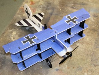

I love the Orbit Eris servos.
Useful compact size.
Strong enough for the six-aileron triplane.
Quiet for a digital servo.
I have installed them in a third plane, and have reordered to have them in stock for future projects.

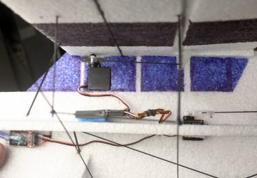

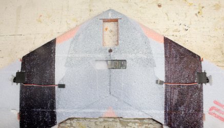

I have mixed feelings about the short cables.

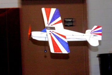

Great fit on the Fancy Foam 3DECATHLON, but I dunno whether to solder or install extensions on the RC Factory ZORRO wing.

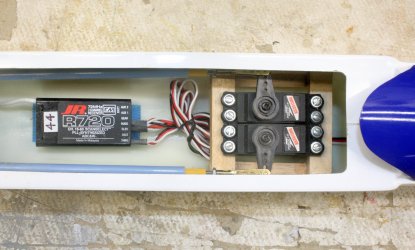

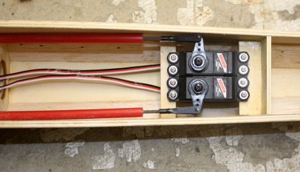

This is music to my ears.
My vote for the next Orbit Servo from Aloft: a powerful mini servo.
Something to match and replace the POWER UP AS3513NG analog plastic gear mini servo.
0.8 oz/23g, 48 in/oz 3,5 kg/cm at 4.8 volts. 35x28x15 mm. Apparently not made any more.
A very useful size for 2 meter and 100-inch glider fuselages.
Photos here show them mounted in Topmodel PRELUDE fuselage, 58 mm wide,
and Mounted in Airtronics Olympic-II fuselage 2.25 inches wide.
Yes, I know the Hitec HS-225 "Mighty Mini" competes in this category,
but at our level, we need and deserve something more reliable than the 225s.
