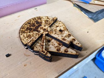

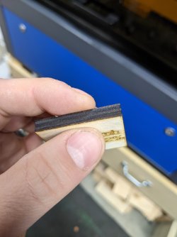

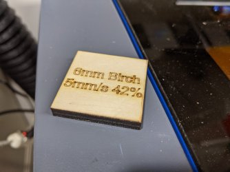

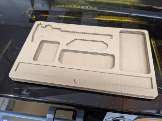

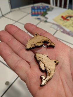

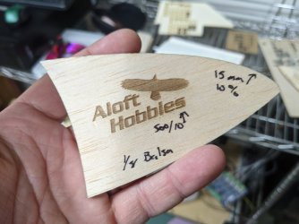

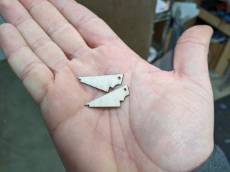

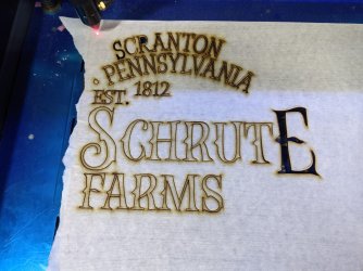

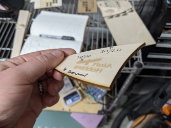

Working on recipes. 1/32 cuts very nice, seen in my hand below.
1/4 ACX construction ply is not going to cut thru, will grab some birch next time.
Mahogany 1/8 cuts nice.

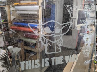

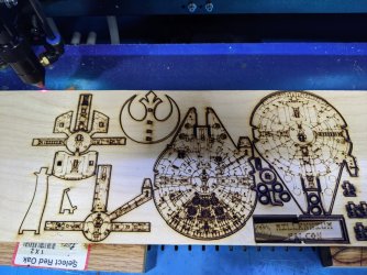

Also engraved some glass which was really quick and easy.
PXL_20201212_190155813.jpgPXL_20201212_193018755.jpgPXL_20201212_203409911.jpgPXL_20201212_204128039.jpg
O wow -- so much excitement here. That's looking GREAT. I'm assuming you are using one pass on those materials??
Yes one pass. Going to test coroplast and foamboard today. Still trying to figure out how to get camera inside. Probably order a magnetic mount.

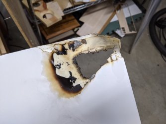

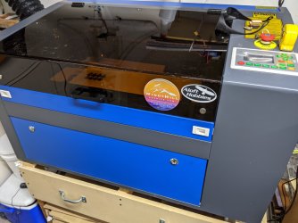

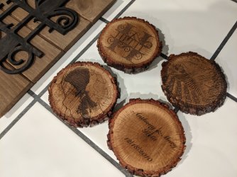

So 3 days now of using it and really happy. Still working on recipes and i have found that the makeup of plywood has much more to do with its "cutability" than its thickness. IE 1/4 construction plywood is almost impossible to cut half way thru whereas 6mm birch ply cuts beautifully at 17mah (21 is my max power). I have used it to do a coaster engraving and it is noticeably finer/sharper than my little diode laser. In the picture below the bottom coaster is diode, top is Co2. I have only started one fire so far lol. Looked away for a second when testing foamboard and my default test quickly got past its ignition point.

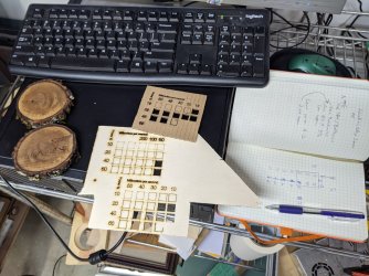

The power percentage increase in Lightburn does not linearly match the mah output of the laser. Like 5% does nothing and at 8% all of the sudden its cutting thru. 100% power is 27mah and 60% power is 21mah, which is 80% of 27mah. So 60% in lightburn is my max setting. This is exactly why the first mod i did was an analog ammeter as linked in the first post.

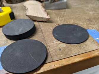

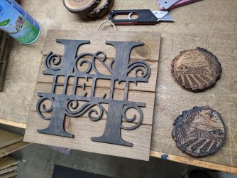

As seen below i tested some 1mm craft foam (bottom of coasters), some 5-6mm leather. A monogram out of 1/8 Mahogany for the in laws, engraved coasters from the wood pile, 6mm birch and foamboard.
Foamboard and craft foam cut really nice and fast. Leather still smells like ass while burning, but the engraving is significantly better than my diode. that design to the left of my name was a big hot mess previously and now i can cut the design out, before i had to use a razer. Also this thing hauls booty while engraving. On my diode laser my max speed was about 2,500mm/minute, but on this im just setting it to 500mm/s which is 30,000mms? Is that math right? Its fast. Like 25 minute jobs down to 5 minutes.

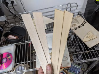

Birch definitely is the way to go for the future when ordering materials, it cuts really nice. Still need to test fiberglass and carbon sheet goods.
On my todo list is to figure out if there is a "materials" library in lightburn i can start setting up. That way i can just select "Birch 6mm From aloft" instead of referencing my notes to input it every time. Also need to get some better/more LEDS inside and externally on the back of the cart. I have a rule in my shop that anything that heats up has bright lights that are on if the machine has power. That way i can easily glance around when leaving the shop to see if anything is on. One time i left a laminating iron on all day on my workbench and it scared me pretty bad.

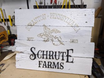

Finished some gifts for the in laws, love me some shellac.

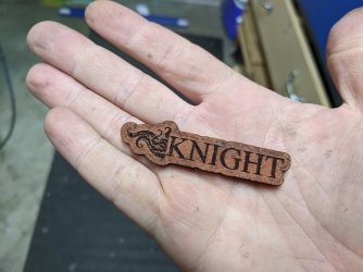

5mm leather engraves and cuts pretty nice, this is about 80mm across and 5mm thick. Trucker hat for @Diceman ?
Trucker hats do not fit me so well, but I have some I like I can print on. The Flexfit hats are my preference. :)
Its really rough on the back side. Its totally thick enough to be a key chain though. PM me your address and ill send it. If you wanna put it on a hat just clamp it on with some flexible glue like shoegoo or e6000 overnight.

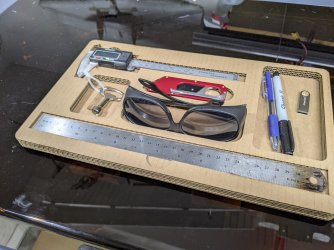

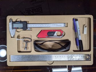

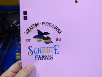

Got to test some colored paper, not cardstock but thicker than normal. Its some Martha Stewart paper pack from Michaels. Cuts super fast at low power.
Nice! That sign came out really nice.
The cardboard doesn't even look laser cut..? No toasted edge?
