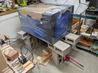

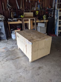

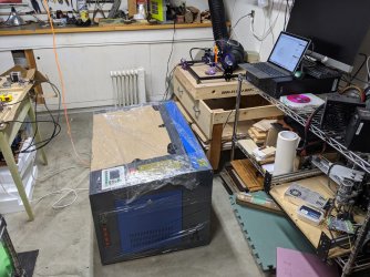

I finally cracked and ordered a chinese laser cutter from omtechlaser.com. They are a company down in the LA area i think, they import them and make sure they are working, so you have a US based company for any problems. Its a 50w (probably 40w as most of the chinese lasers are rated at peak and you gotta keep it at 80% of that). 12x20 cutting area, same as glowforge, but has passthru. After shipping tax it comes out about $1,300 less than a glowforge. If you have any interest in the experience let me know. Im sure at some point ill do a little video about how well/not well it goes. I made sure to get one with a Ruida controller so i can easily transition over using the same Lightburn software im already used to on my little 5.5 diode laser engraver.
Heres the specific model i ordered with a 10% off coupon. Being in california the shipping was free which is usually $250-300.
Starting this thread here to document the experience.
Heres some related videos if you interested:

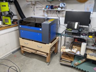

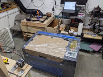

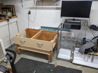

Made a base for the laser this weekend. The laser is 40" wide and 26x25 so it needs to be raised off the ground.

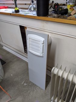

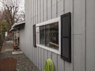

6" thru wall vent:

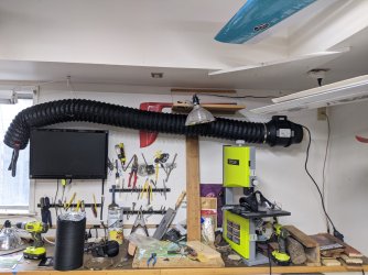

25" of 6" ducting
390cfm 6" Hvac blower:
These blowers are much quieter than the included "pc fan" setup most lasers come with.

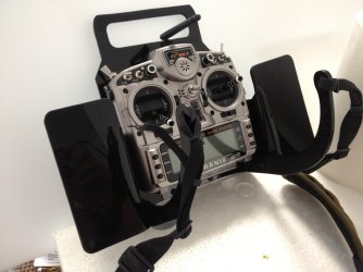

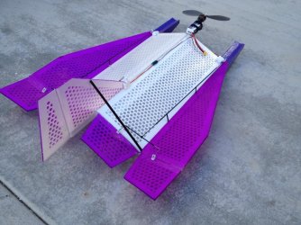

I'm excited to follow this thread. I had access to a nice laser cutter when I was working -- but the ONE downside of retiring was loosing a laser cutter. I used the laser cutter to cut plexiglass for making transmitter trays and depron for models. The "capricorn" below has a honeycomb cut into the depron using the laser cutter. Surprisingly this yielded a stronger model as cracks would not propagate through the holes..... That is ... until I lost my balance in my former tiny hobby room and fell into this model.
