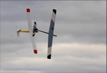

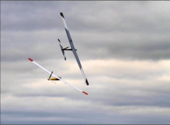

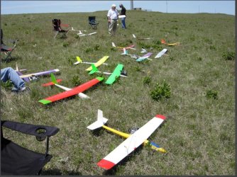

For inspiration - a few ODR photos taken by Dave Garwood several years ago. His photos are what first got me up to Midwest Slope Challenge.
Hope you guys pursue this. ODR racing started in California would be cool if you brought it back.

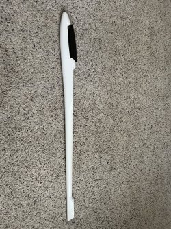

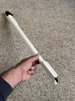

If you want an easy fuselage solution for your early builds, CLM Pro does sell a fuse that meets the rule parameters. (If you want to start with a top wing mount.) Super light at about 99 grams / 3.5 ounces. Made for a V tail.
I’ll be making a new ODR this winter and will use this fuse. But will put a block of balsa in the V notch and make a cross tail. Will cut out most of the wing saddle area for ballast access and servo wires. Will add some reinforcement in the nose area since some nose weight will be needed. And will probably add some carbon tow inside the wing saddle area.
About half of the ODR models flying at the Kansas race are EPP fuses like the Dusters in Dave’s photos.
Just throwing out a simple solution if it helps. Really interested to see what you come up with. Hoping you go full Red Alien mode on a fuse concept of you own : )

Good option, thank you. Yeah I do really want to do my own fuse, but I should play with planforms and sweep angles before committing.
