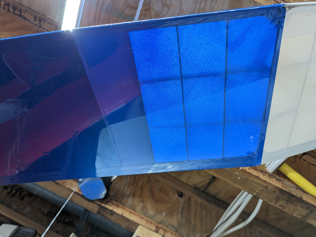

That said, I've used this method for covering on my Olympic II, parts of my Gentle Lady, a wing and something as small as Lightning Bug DLG (came out around 100-125Gm?).
Try ‘Rolling Your Own’, 'Monokote' that is.
  • You need a roll of 1.5mm Laminating Film (it does come in other weights, I've seen 1.7mm referenced by other users). www.laminator.com was my source. Two years ago I paid around $30 for a 25”x500’ roll, delivered. That's 12,500 Square Feet of Covering Goodness!
  • Cut a large piece film from the roll and tape, adhesive side*, up to a piece of cardboard/paneling/plywood/OSB, etc., large enough to allow overspray.
  • Apply Two light, mist coats of spray-paint, with plenty of drying time in-between.
  • You can make patterns from poster board, weighted down with lead, shifting down as you spray.
  • Don’t roll it up afterwards.
  • Apply to model, painted side down, using your Monokote Iron. I had to turn the heat up a bit.
  • Practice, practice, practice. It’s CHEAP! Cheap spray paint works fine.
  • This will give you a translucent to solid color – transparency probably not possible.
*Just like commercial coverings, there is a shiny side and a dull side. The dull side is the adhesive side and YES, your are painting over the adhesive. The paint essentially becomes your new adhesive. There is not clear film layer to remove as you unroll it.

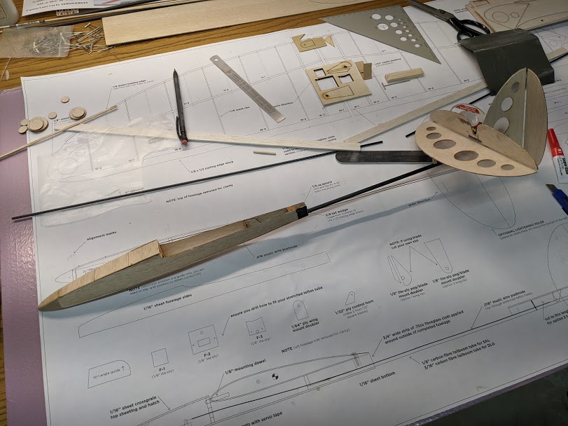

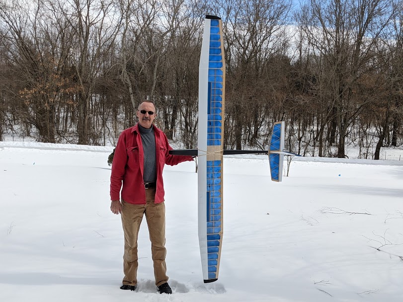

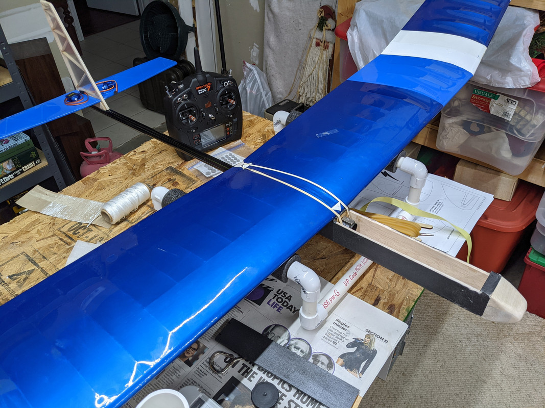

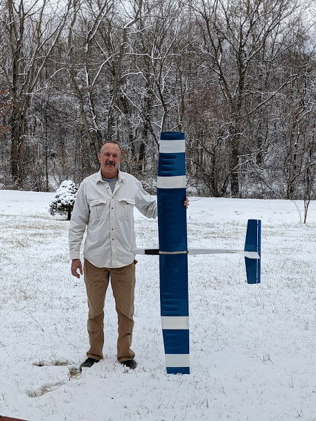

This is my Lightning Bug DLG (https://outerzone.co.uk/plan_details.asp?ID=10430) 34" wingspan. Typical weights are 100-112Gm. As you can see, mine came in at 96Gms with a Buzzard Models Micro Rx, 2Gm servos and a Nano Tech 3,7v 300mAh 1S Lipo. I spritzed the wing balsa with spray paint before covering and applied the laminating film (LF) left clear. All the wood was left natural ... er, uh, I may have applied some sealer. I'd have to go back and look

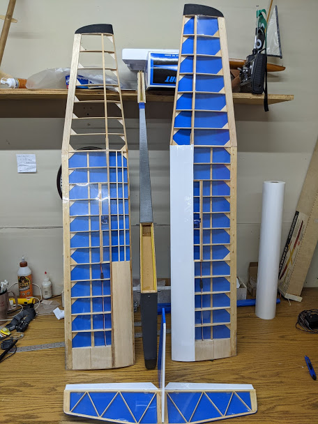

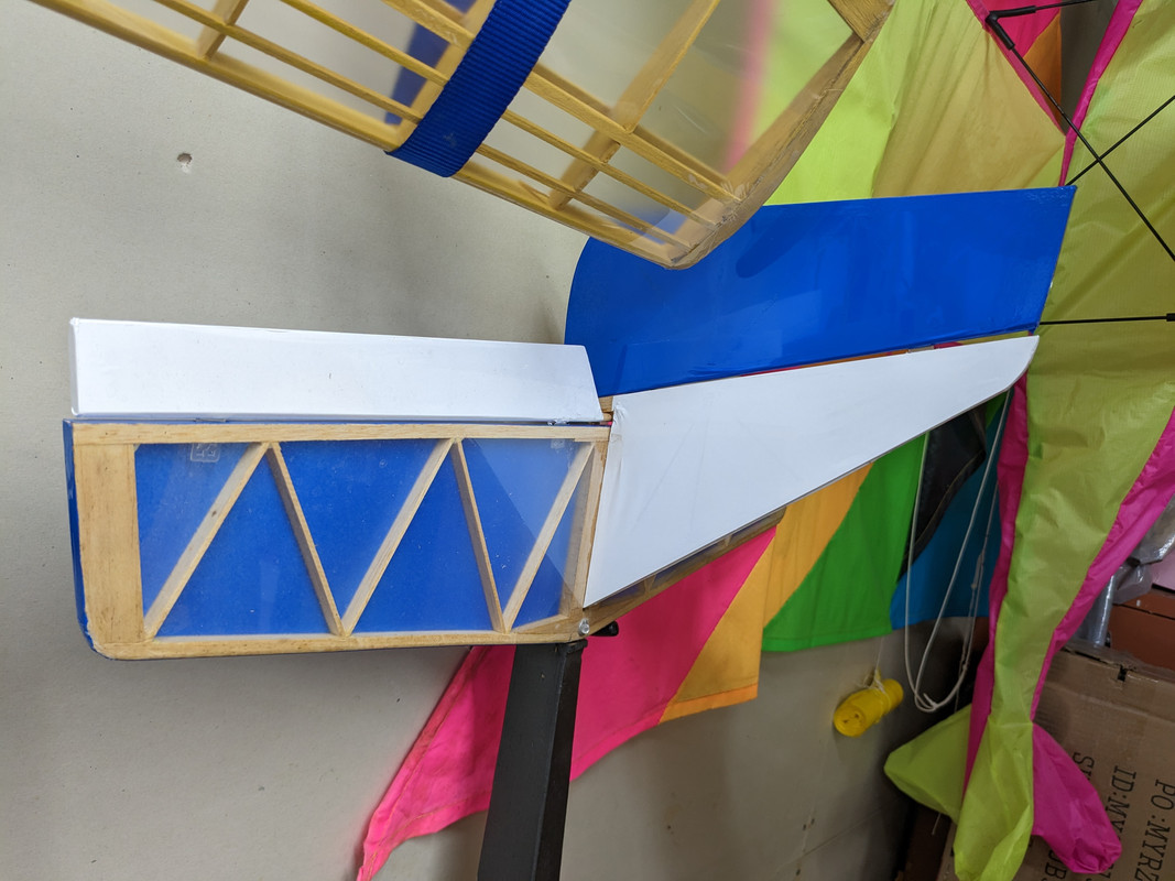

The above was my Fuse v2.0. This is v1.0, with LF on the tail empennage.

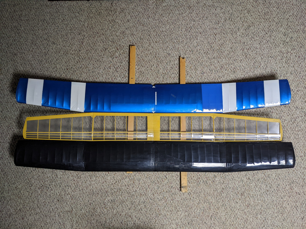

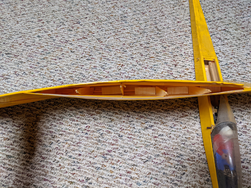

This is my Olympic II. The fuse is sealed and spray painted with Rustoleum Black Hammertone. The bottom of the wings is covered with LF, sprayed blue, the leading edge has white commercial Monokote and the top is covered clear. Tail empennage is treated in a similar fashion, with the blue LF applied to the rudder, white Monokote to the elevator and vertical stabilizer.

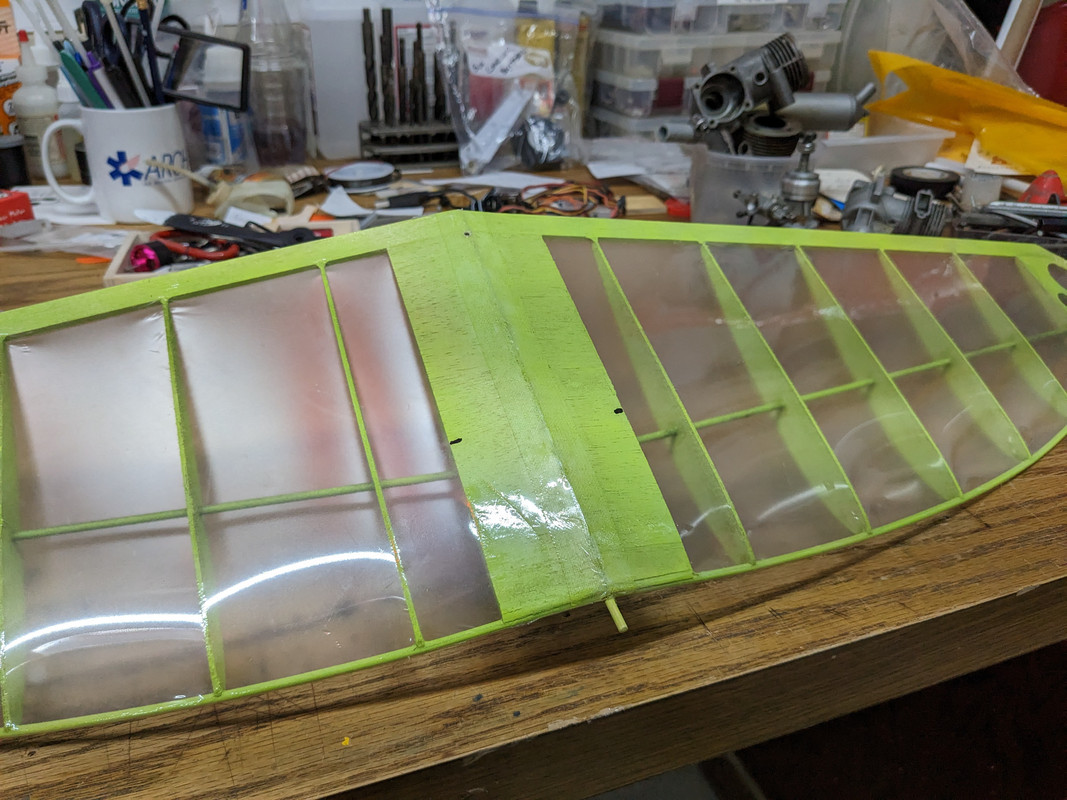

This is my 'Franken Lady' (fuse was destroyed and replaced with a pod/CF boom). Pod is painted with Rustoleum Black Hammertone; the repaired wing patch is the same blue as on the Olympic II, above; the horizontal stabilizer/elevator are covered with the same blue; the vertical stabilizer/rudder are finished clear.

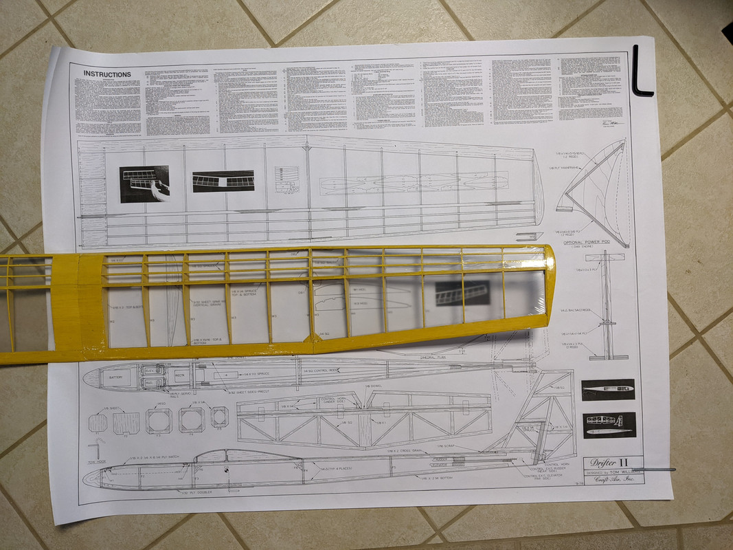

I almost forgot. Here's a Drifter wing, that I received from another former club member, along with a Gentle Lady and a Sophisticated Lady. Took a bit to figure out what it was, as it was just dumped at the clubhouse with my name on it. <grin>
It 'came with' the Sophisticated Lady' and I thought they were mates at first. This was the condition it was in:
And this is my original GL Wing, the Drifter Wing, repaired, painted yellow and covered with clear LF, and the Sophisticated Lady Wing.

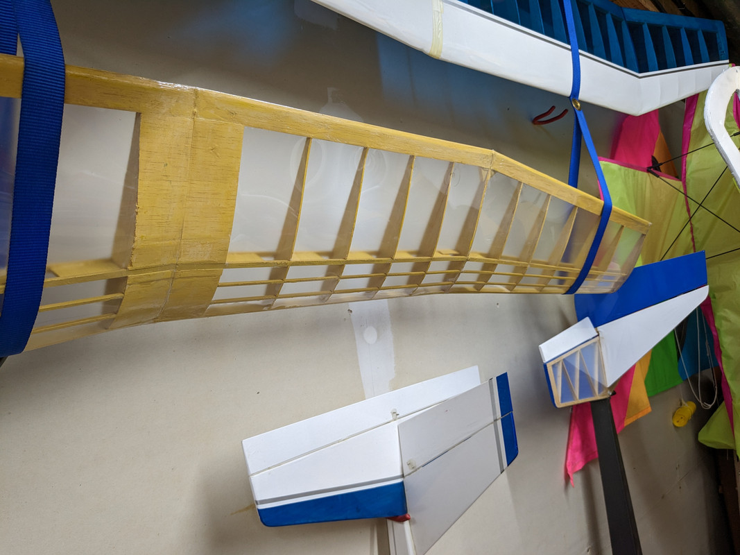

The Lightning Bug DLG is two years old. Have not touched the covering on it. Now, that's adhesion to painted balsa, as opposed to painted LF adhesion to bare balsa. You can see that the LF is still holding strong to the sheeted surfaces and still looks good. Any crud in there is due to my lack of meticulous prep of my work area, resulting in balsa dust getting trapped inside. I took this picture minutes ago.
This is the Drifter Wing after about a year. Now, to be fair, it's been hanging in the basement, as I'll have to build the rest of the glider still. More clear to painted balsa.
This is the Olympic II tail after two years. Clear and painted blue, bare balsa, ribs and solid surface. Wings look just as nice. Some wrinkles present in the tail, both to LF & Monokote, but probably due more to installer error.
This is the Gentle Lady (Franken Lady). The translucent patch is painted LF applied to bare balsa, to compare with 25 (approx.) year old monokote (blue and white, seperately).
