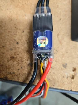

So just making sure I have the wire in the correct spot for telemetry or is it supposed to be soldered to the bigger pad?
Also the new settings seam to be working better.

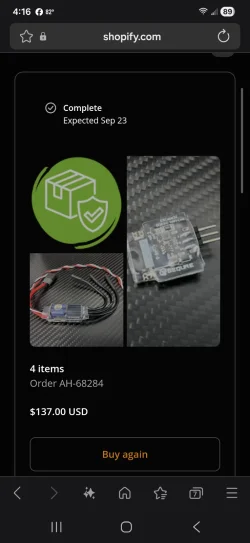

Then in that case, we should probably get it back and have a look. What was the order number for this ESC? That way we can email you a return label.
