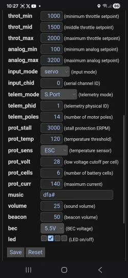

Yes, they support S-port, and talk very nicely with FrSky gear. You do need to use the wifi connection to set the telemetry to frSky as it is setup to KISS telemetry by default.

We helped a customer on Friday with the same unit on a ducted fan and for him the only issue was the timing needed to be adjusted to 10 degrees and all was good, but he was having stalling issues, not heat issues. (His cheap servo tester was also causing issues.)
Correction - The Sequre ESCs tend to have less than great default settings. The sine wave and brake settings were also adjusted for the customer to get his motor happy and stop making heat in the motor.
Sine Power = 4
Sine Range = 0
duty drag = 0
Duty lock = unchecked
disable complementary PWM
Timing = 10 (for high RPM setups) 15 or 16 for more sane RPM applications.

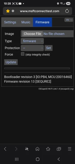

I assume you have the wifi board, please connect and send us a screenshot of the ESC settings.
Getting one bum unit is always possible, but 2 is far less likely.
Here is the settings of both units. They are setup identical.

I would set your esc timing to 10 degrees, set the sine range to zero and sine power to 4 (Those are crawler settings, not good for EDFs.) Then set the duty drag to 0 and disable complementary PWM.
