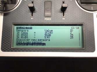

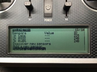

I haven’t flown my helis this year, mostly my quads. So I noticed my telemetry wasn’t working on one of the helis. I was running OpenTX 2.3 with a X9E, X6R and a FLVSS. Also have two MLVSS. The radio will “discover” all three sensors but now doesn’t show any values. I’ve updated to OpenTX 3.2.1 and still no joy. I’m noticing an occasional, brief flash where the sensor value should appear (three dashes) like it’s trying to display something but it also did that before I updated to 3.2.1. I have a second heli that also has a X6R but with the FrSky FrESC32 and the telemetry still works with that setup as before. I’ve tried every possible combination (both of my X6R’s with all three sensors and the ESC) and I get nada from the FLVSS/MLVSS sensors. I did update my X9E internal module to V2.1.0 and the X6R’s last spring and everything seemed to be working then. Also I don’t have any problems with telemetry on my two quads w/iNav. I didn’t reverse the polarity on the MLVSS sensors and the FLVSS is polarity protected. I’d be surprised if all three sensors were defective or dead.....how bizarre. Any ideas?

SUCCESS!! I tried going back to the previous OTX 2.2.4 I was using and that didn’t work either. So as I’m thinking about it I decided to just do a factory reset and sure enough, it did the trick! I didn’t even care about trying to save any of my settings/models as I’m only using two helicopters and two quads for now. No clue what was causing the problem but it’s fixed and that’s what counts. I’ve always said, I may loose a battle or two but I always win the war!
