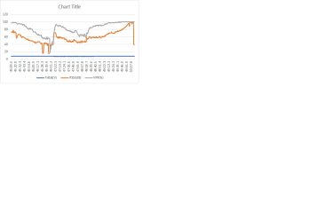

My results are much better, model sitting on the ground (road in front of house), 100ish paces to first cutoff, taken out of range mode and walk another 100 paces. Turned around and came back. This is an RS8R stabilization rx in an Eflite Havoc edf.
Still seems odd that you only get about twice the distance in regular mode vs range mode. Shouldn't the difference (or ratio) of the two be much larger?
