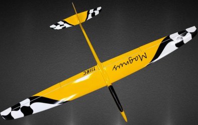

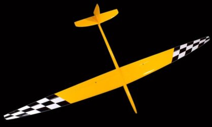

Thanks for the quick reply. Was hoping it would be ready sooner, but that would likely mean little to no prototype testing or refinement. So that means now I either need to be patient, or get something like this glider to go along with this glider. They would make a nice duo on a windy slope.

You could try a Forza from Aloft. Far more advanced than the Typhoon (I designed both) and a little lrger at 2.5M but a great flyer.
