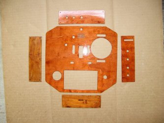

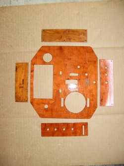

Here's my attempt to post an image of the wood panels from my single stick kit.
I used a water based dye - red mahogany - from Lee Valley Tools. Over coats were a solvent based polyurethane.
The front, top and right (control) wood panels are just the dye and poly..... I like the way the grain and color pops out and will go with this
The other two small panels were an experiment with adding .75 ounce per sq. yard fiberglass cloth and laminating resin, with a top coat of poly. The cloth was to add scratch resistance but I don't like the relative dullness of color and will surrender any doubtful extra protection. (I applied the fiberglass cloth to the inward facing side of these two pieces; the outward facing sides are finished per the other pieces and appear like them.)
If you click on the image, it should enlarge and you can better see the wood grain "popping".
(If someone can rotate the image so the top of Tx front panel is at the top, it would help.....smiley)
That looks great! nice work. the finish should wear well also.
Kelly

like this ?
Jure,
Thanks for the rotating the picture of my red mahogany dyed wood face panels for the single stick.
