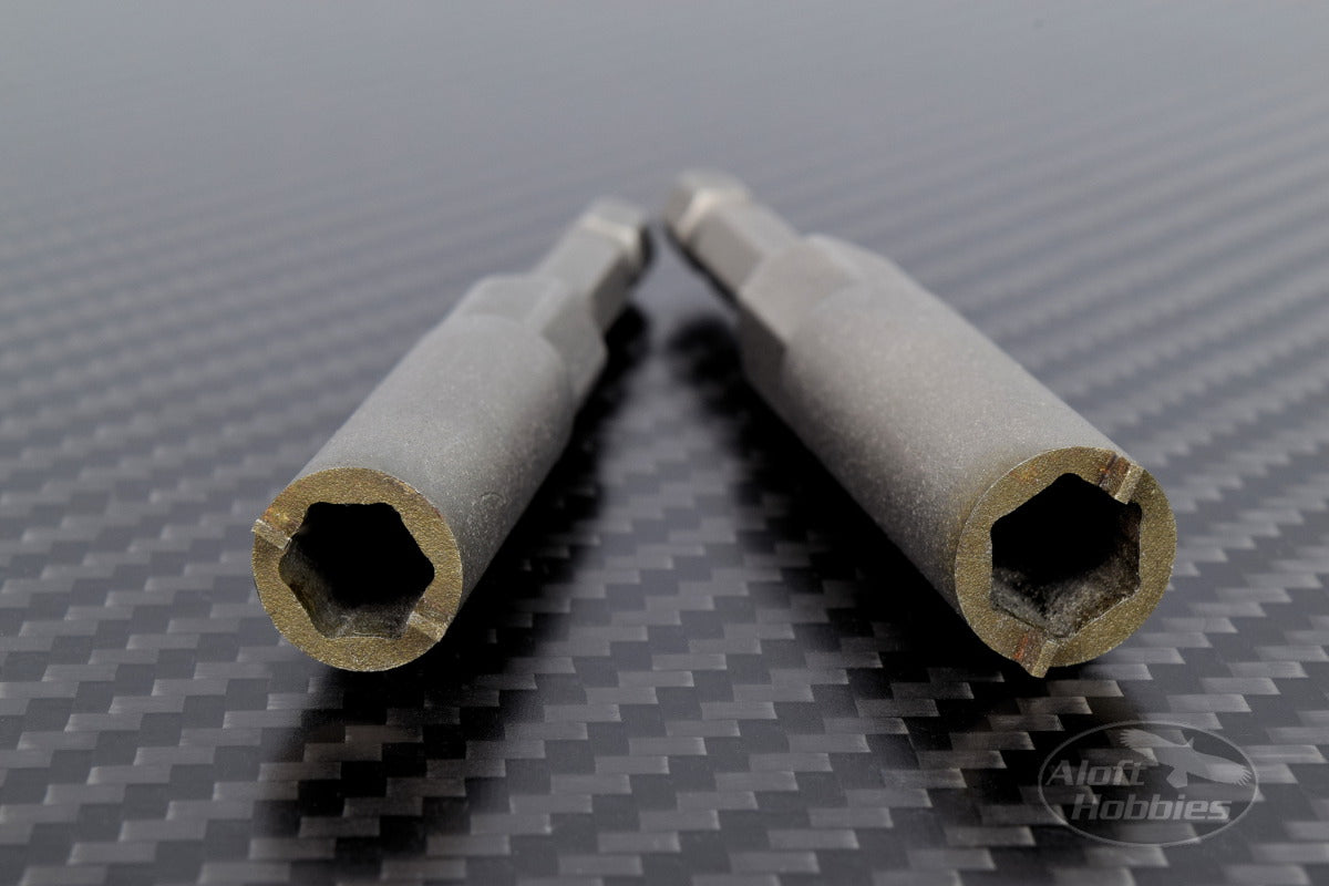

Do you sell the driver for the chrome bezel nuts?

Currently sold out of the nut drivers:

In the absence of tx nut driver, I think you could achieve the same function with a bit of flat 3/32" aluminum, a portable grinder and file to create the notch for the nut protrusion and engage the slots..... think of the vintage wrenches that came with the same Cox engines.
