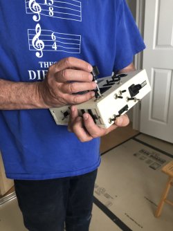

I think we need to clarify a full feature 3 axis single stick from the earlier entry level 1, 2, & 3 channel radios of old.
Here I’m holding an 8 channel radio all the primary flight controls are done with the right hand. The left middle finger controls the throttle and throttle trim. The left hand also controls all the features on the right side and on the top. The right hand has easy access to all the face features and switches.
Generally the radio is cradled in the left forearm and against one’s tummy.
This radio is great if one has lost some or most function on one side as the primary flight controls can be manipulated with one hand.
