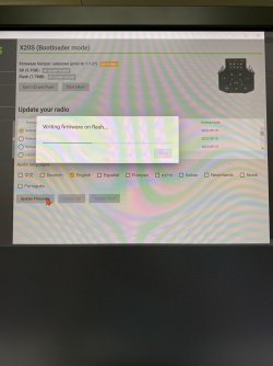

I followed your instructions and successfully installed the bootloader on my TandemX20s. I then downloaded the latest firmware version off of GitHub tans used the Ethos Suite to upgrade the firmware and it started out well but then the writing firmware on flash froze? See attached picture. What next?
Raymond

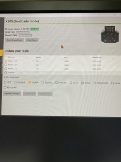

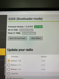

Henny,
Looks like I “jumped the gun.” I disconnected the Tandem and closed the Ethos Suite and reconnected in bootloader mode and selected the X20S and it says the firmware is up-to-date.
Guess the frozen screen is just a software bug or perhaps the way it is supposed to work.

I have seen a couple of cases where the flashing stopped for no reason. I suspect a cause maybe due to the transmitter trying to charge from a USB connection where the PC can't supply enough current causing the voltage to drop enough so the TX processor stops working. So a suggestion is to charge the TX before performimg the USB connected updates.
I have seen a couple of cases where the flashing stopped for no reason. I suspect a cause maybe due to the transmitter trying to charge from a USB connection where the PC can't supply enough current causing the voltage to drop enough so the TX processor stops working. So a suggestion is to charge the TX before perform and USB connected updates.
Thanks for the advice, battery for TX was above critical level but I had used it a lot trying to figure out how to get the bootloader updated. Will remember to charge the transmitter first before trying updates as this makes perfect sense.
