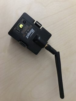

Has anyone else had difficulties with these? I had multiple dropouts/ range issues with these the last weekend at Sunset when using it in the DSM/DSMx 22ms mode in a Tarranis X9D box.
I subsequently tested the range on the ground with different receivers and got as far as from the back fence at Sunset down to the parking lot. When I tested the same receivers with
an DM9 type module all was fine again, so clearly the multi module. I then tested with a friends module and the same crappy performance with that one too. I have an older version of the same module and it seems to be short in range as well. -- FW versions are all different from old to latest -- doesn't seem to make a diff. Air frames tested are balsa or foam and antennas are outside and oriented differently.
I'd like to hear from others if they successfully used this on the spectrum protocols without getting RSSI warnings and loss of link at every turn. -- GS

What I found on these 4in1 modules is that they have a horribly poor receiver as evident in the RSSI readings displayed compared for example to the readings you get from the built in FRsky or on an other Spectrum box. It probably stems from the need to switch the RF signal to one of the 4 chips internally. I would not be surprised if that's the cause for the poor performance when operating in a crowded field, as the system might be duped into thinking that certain frequencies are quiet when they are in fact not. Transmit power looks like is on par with the native Spectrum system and plain range, in a quiet setting, is the same as well. So either the RX sensitivity or some other SW snafu .
