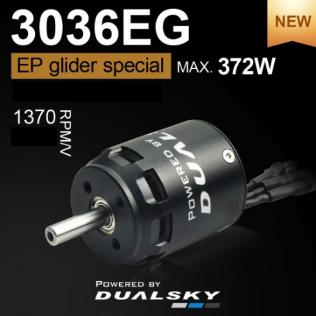

Here is the motor we suggest for the sister ship we sell, the Alpha 2. (Same wing as your plane.)
