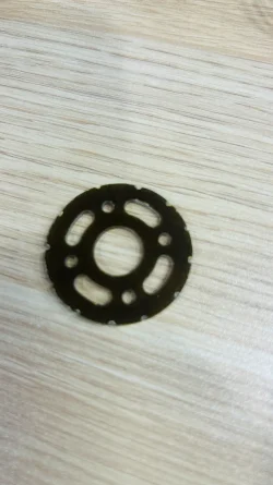

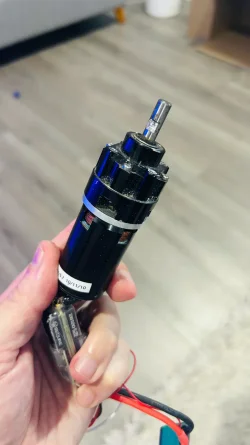

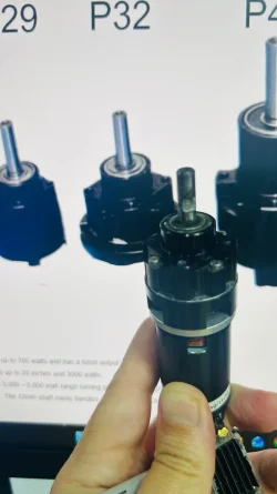

Hello, I am building up an Ion Pro NG. It came with a 2mm thick 38mm motor mount. The problem is the gearbox, a P32 gearbox which has mounting holes at 27mm vs the 25mm of the mount the airframe kit came with.
Can I widen the mount's holes to fit the gearbox mounts or would that be risky? It will be over 1kw of power.
I've looked for motor mounts but cannot find a 38mm with 27mm mounting holes, so here I am.
What should I do here?
I attached pics of what I am working with.
Thanks!

You can probably just egg out the holes, should be right at 1mm per hole.
If you like we can make up a custom motor mount for you. See this page:
I'd probably take the thickness up to around 3mm. Should work a treat. I dare say might be better than the supplied motor mount as we have a lot more glue area on the fuselage. We will need to inner and outer diameter of your fuselage.
