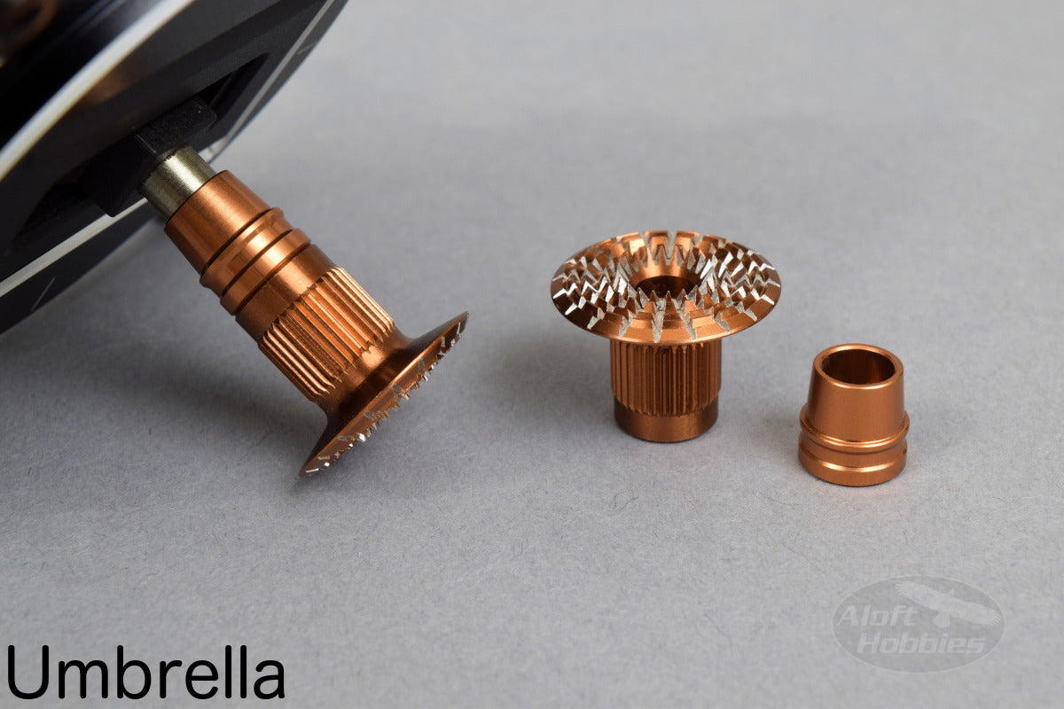

Wait..scratch that. Will these fit the X20?
Might want to give one of these a try, many styles.
Should be M4 threads on your sticks.

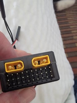

Now something else I'm stumped on. Archer SR10 from a 7.4v 5400 dualsky lipo. Usually, you can run the lipo to a "servo" channel on the reciever. I have not attempted this yet cuz I don't know these recievers. Used to be channel 9 on spektrum..
On the Archer I see two, very small yellow plugs that say vbat. Never seen them small, dinky plugs before, so now I'm trying to find a switch and harness to go battery to reciever. Or, what adapter I need to use or if I just need to take a sledgehammer to the plug on the battery to make it smaller lol.
Told ya, lots of stupid q's trying to close that 8 yr gap...
The SR10 Pro has dedicated XT30 ports for the power input. You may need to do a little soldering to add this connector to your batteries:
We can do this for you if you give us a note when you are ordering a product. If you don't solder, you can send the battery to us and we can do this, but shipping both ways adds up.

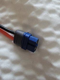

Ok, what I would need is a basic two position with charging/balance port I think to go from battery (dualsky 2s 7.4 5400 from you) to the switch, then from the switch to reciever, or a magnetic but once installed in plane, the reciever battery is going to be difficult, to say the least, to get to. So from battery (blue plug) to switch, then to the plug you posted above.
I'll be ordering in am. If there's a magnetic switch that can do that, even better.
The engine has to have 6v so a because without a voltage regulator is kinda out. Plus, just more things, troubleshooting, if things don't or stop working. Trying to keep dedicated systems, for now, until I close some more of that 8 year gap.
Other than an optical kill, no connection between systems.
You recommend, and make up the needed plugs/adapters and you can take my money lol. The wife done said order what I want from you cuz she gets candy lmao.

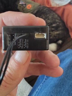

I assume the white port is a power out to, say, a retract controller?
