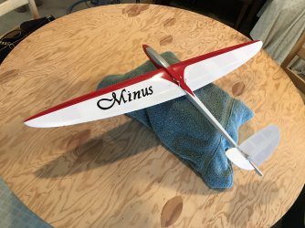

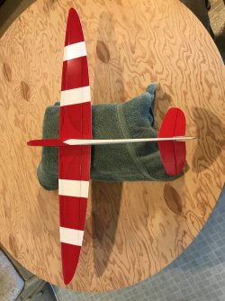

Konrad reached out and asked that i help close out this thread. He finished his Minus Thermic and maidened it at Sunset. You can see his reply here and some final pictures. He said he wants to try the minus acro and hope it won't take 7 years to complete.
Hank

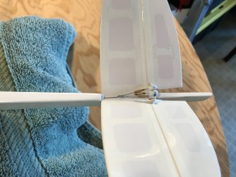

"I maidened this highly modified Minus Thermic at Sunset Beach. I only have 4 flight on her but I’ve met all the design goals! Like with so many other models/kits, following the plans result in poor system integration. Key to my success with this project was cutting down the aileron servo arms. I can use 100% of the servo resolution. I can also do much the same with the V-tail flappers. After the maiden I’ve been pushing the CofG aft. I started with the 600mAh single cell battery all the way forward and 2.5 grams of added weight. By the forth flight I had removed this weight and moved the battery aft as shown. She still flies a bit nose heavy. Roll rate is a bit slow but that might just be because I wasn’t flying as fast as I normally would. I’m thinking I might cut down the aileron control horns from 11mm to 10mm.
The last feature mods were to make the hatch large enough to gain access to all the servos. I also added a T key to act as an anti-crush spreader. After testing the structure through Aloft’s shelving units I added a doubler from the rear of the stock plywood doubler to under the rear top sheeting. This was just a design weak point.
I’m now starting the minus Acro. I hope to have it finished in a bit less than 7 years! "
Hank
Konrad adds that the Minus Thermic came out to 135 grams AUW.
He is working on in flight pics. But here is a glamor shot.
