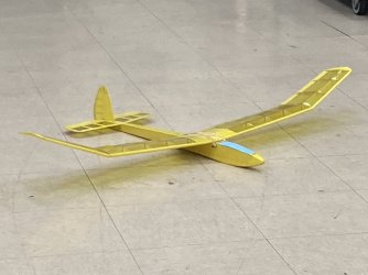

4.4 Oz. (125g) RTF. I’m thinking about making the TE and ribs out of 3/32, they are 1/16 now and a bit flimsy. I want these to be easy to build for the average person. Maybe the tails too. Anyway, looking forward to the first flight.

Couldn't help it, I had to take it out in my back pasture for some hand tosses. Sorry for the crappy video, I just stuck my phone on the fence.
I'm thrilled! It flies fantastic. Slower and floatier than the micro one. This thing will be a light lift machine, perfect for those days where you just want to cruise. It was much darker than the video looks, I wanted to keep flying lol.

your model , besides being outstanding in every possible way , was flying thanks to the kind support of the field mice (grin)
Awesome!! Flies even better than I would have thought from a hand toss!
We could go to thicker contest grade balsa, but not sure it would be stronger, would maintain the weight. I like the idea of a little thicker material, but not if it will harm the flight performance you show in that video.

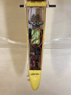

I think the jump from1/16 to 3/32 in the wing won't add any appreciable weight. I had to laminate the spar and my wood wasn't the greatest, so probably a wash. Even if it was 5 oz. I don't performance would take a hit, this is really the sweet spot I think. I am going to add a little plywood to the radio tray and belly for a tow hook. Guess I better figure out an E option too.

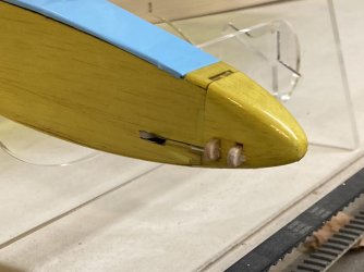

Since we have been plagued with calm conditions, I installed a tow release in the nose and did some aero towing with it this weekend. Worked great! It has a very low sink rate, on par with my buddies composite DLG which is amazing.
