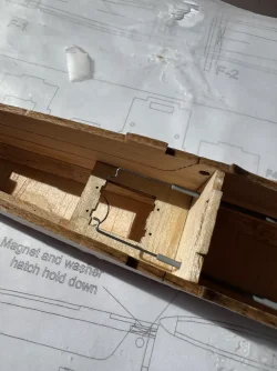

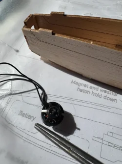

Working on the mini wanderer today and noticed someone took the time to put Z bends on one end of the pushrods. Nice touch…thanks. That is one tiny motor!!! Great kit and fantastic instructions. I always do this but I am already wondering about a second set of wings with less dihedral and ailerons. Hmmm🤔
