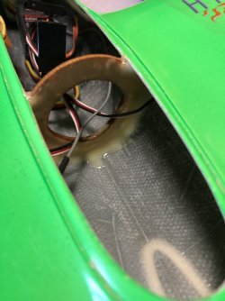

Sry my numbers were a little off. Elevator throws are 3mm up / down. Elevator is even w/ the trailing edge at full down. Ailerons are 6mm up / down.
I didn't get a chance to play w/ it too much as both Jeremy and I started racing each other right away on my maiden...
I was in a big hurry to finish so I just mixed some cab-o-sil and 15 min epoxy and made giant fillets on both sides of the wing joiner.
Seems to be very strong as one of my servos came unglued on a rough landing and it didn't come lose. :)
