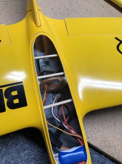

So I did a quick strengthening to the wing and it worked great. I just added pieces of bamboo skewers across the gap and it made it a lot stronger. Time to try out the DSability!

The front red line would be to far forward for me, I want to be able to get the battery out. LOL. But yea, you get the idea. The curved one I do not think would be as strong as a straight one. Just my 2 cents. :)
